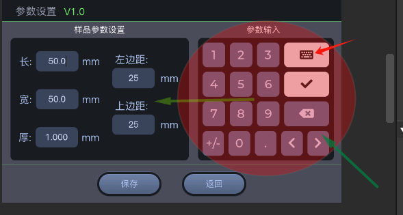

I want to ask is there a way to move the lvgl keyboard casually?

What function can be used to move the keyboard on the lvgl screen to any position
If possible, add screenshots and/or videos about the current state
You can make it draggable using events, see this example
