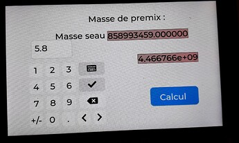

Set a double value in a textarea, calculate with another double value by pressing “ready” on the keyboard and displaying the result
-I try to extract the string of textarea with “lv_textarea_get_text” and extract the number with “strtod”.
-It works perfectly with an integer but never with double or float.
-I already set the “lv_use_float to” 1 in lv_conf_9.h
-change the “programmer” in arduino ide

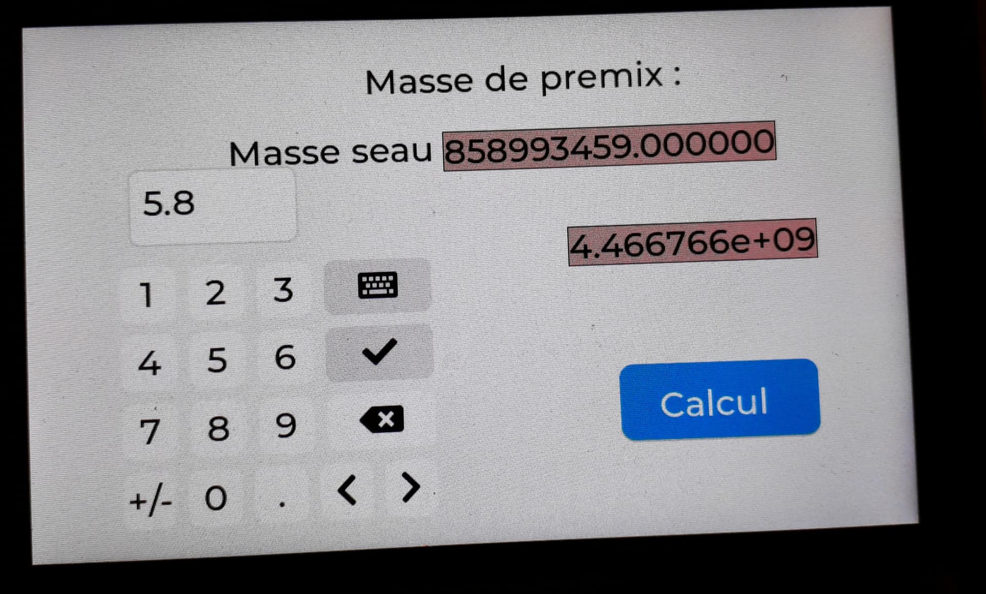

first value is “ui_LabelValeurEau” and below is “ui_LabelEssai”
