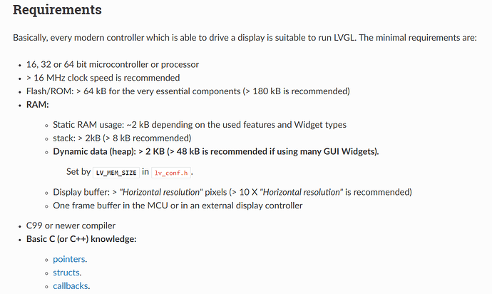

what is "very essential components" in LVGL? What components are included?
I am not sure how accurate the needed flash size is. I want to say it is much larger than that as a default. something along the lines of 1024kb. This is with a lot of things turned on. Fonts take up a very large amount of flash space so I would recommend only turning on the ones you use.
you can turn on/off all of the different widgets and technically speaking you don’t have to add any of them if you don’t want to. You can use the LVGL rendering engine to render your own widgets if you want.

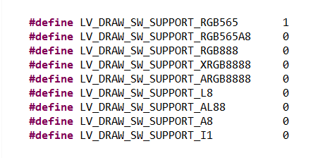

Is there any way to reduce it? I tried following the image below but it didn’t work.I aim to achieve 64kB flash
The omnly thing you can do is basically go through the lv_conf and turn everything off including the fonts and see how small you can get it to be. The fonts use a lot of flash space.

I disabled these items as shown below.
set the following to 0 s well
