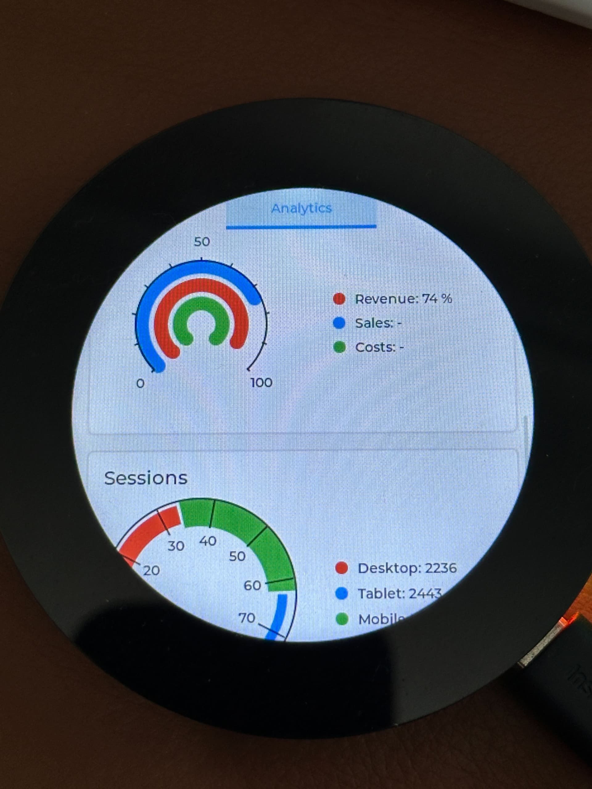

Hi @JkstrE! I have that same board and I’ve done some changes to their ESP-IDF example project to make it compatible with LVGL v9.
Please take a look here: GitHub - giobauermeister/waveshare-round-esp32-lvgl: Template project for Waveshare 2.1 round display with support for LVGL v9 and ESP-IDF v5
Try compiling and flashing that project on your board and see if it works for you.
