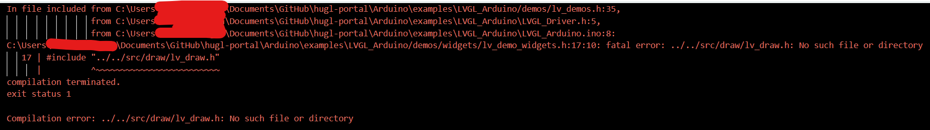

I’ve just downloaded the getting started code from the Waveshare Wiki, and am running into compilation errors… is there issues with the code or with my setup?
Waveshare ESP32-S3-Touch-LCD-2.8C
I traced the rabbit hole of trying to fix the include errors thrown but kept getting new errors so wondering if there is something fundamentally wrong with my setup. I redownloaded a clean version and am back at square one…

Thanks! Good to know the example doesn’t work out of the box and it isn’t just me.
I’m having some issues with the include statements at the top of the main script. I’m compiling it through the Arduino IDE if that makes any difference. For example,
#include “TCA9554PWR.h” as well as
#include “PCF85063.h”
