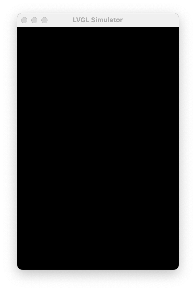

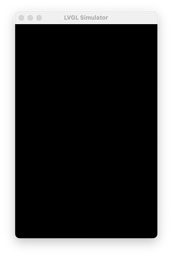

The simulator window opens but in the background. It is solid black and unresponsive. I wasn’t able to close it except by closing VSCode.
