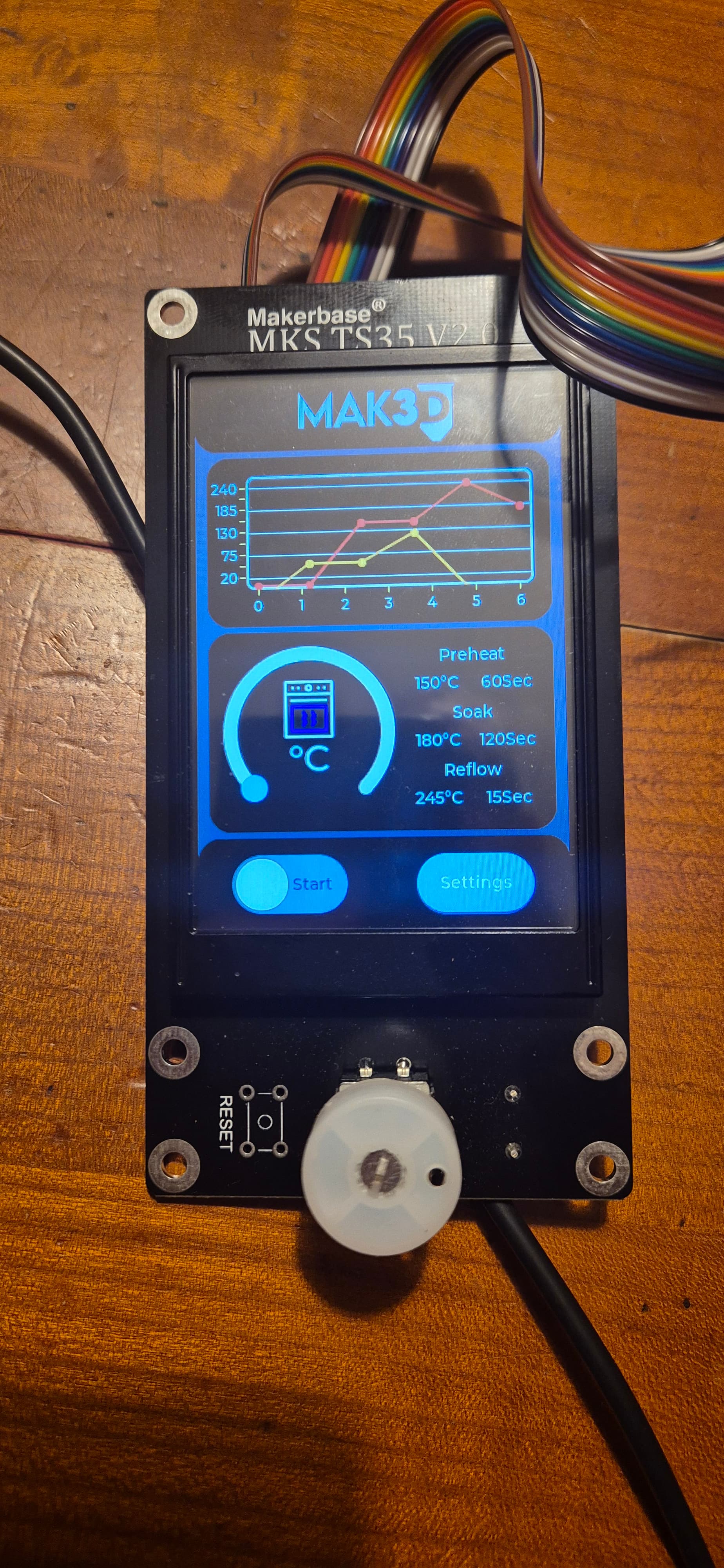

i have an ESP32-WROOM-32 and a Makerbase MKS TS35 display and i would like to know if it’s possible to use this display?
i have read this display use the same driver as ST7796,
if anyone have an idea ? i have for the moment just the backlight
thanks all
florian

it’s ok now, I used the 9488 driver and 16 bit color, I use a resolution of 480x320
Today I am looking for what kind of touch driver I need to make the touch work

Hello,
it’s ok for me, i have used multiple parameters,
in your user_setup.sh :
i used the ILI9488_DRIVER
TFT_CS was LCD_CS on MKS TFT
TFT_DC was LCD_RS on MKS TFT
in User_Setup_Select.sh :
#include <User_Setups/Setup21_ILI9488.h> // Setup file for ESP32 and ILI9488 SPI bus TFT
In Arduino i used <XPT2046_Touchscreen.h> for touchscreen,
CS_PIN was TOUCH_CS on MKS TFT
IRQ_PIN was TOUCH_INT MKS TFT
you need to put 5v on LCD_BLK to active light on screen
you can use this to see where is the pin :
