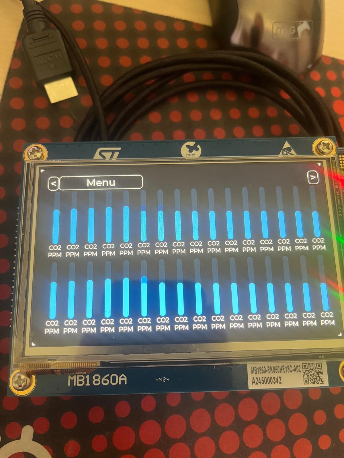

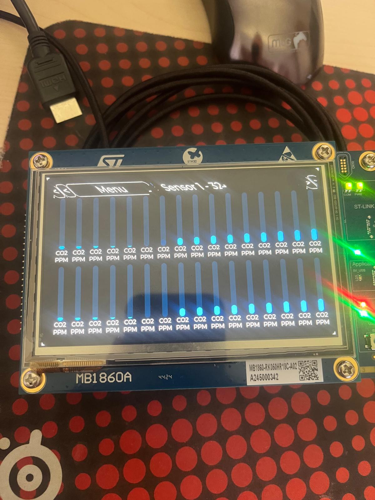

My Touchpads “Icons” are getting messed up whenever I press the them.
Befor Pressing:
After Pressing:
The GT911Driver_handler() runs in Blocking mode so this might be the issue. Do you have any experience with this?
