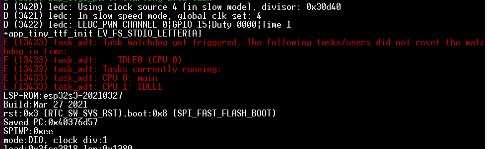

I set it up as follows.
CONFIG_ESP_TASK_WDT_TIMEOUT_S=30
After booting, task wdt occurs as shown in the image below.
Is there a solution?
