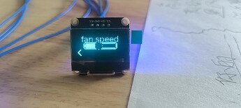

I want to make the local style effect for the indicator part of a slider. Because LVGL’s mono theme can’t display indicator part, i tried to use local styles to make indicator part appear, but the code below doesn’t work:
    lv_obj_set_style_bg_color(slider_fan_speed, lv_color_hex(0xFFFFFF), LV_PART_INDICATOR);
    lv_obj_set_style_bg_opa(slider_fan_speed, LV_OPA_COVER, LV_PART_INDICATOR);
I have done the same thing to the knob part of the same slider, the local style worked well.

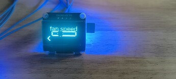

I don’t know why after i have added the sentence below, the indicator part appear:
lv_obj_set_style_radius(slider_fan_speed, LV_RADIUS_CIRCLE, LV_PART_INDICATOR);
This seems to be a bug of slider. Only by adding the following statement will the indicator appear.
lv_obj_set_style_radius(slider_fan_speed, ... , LV_PART_INDICATOR);
