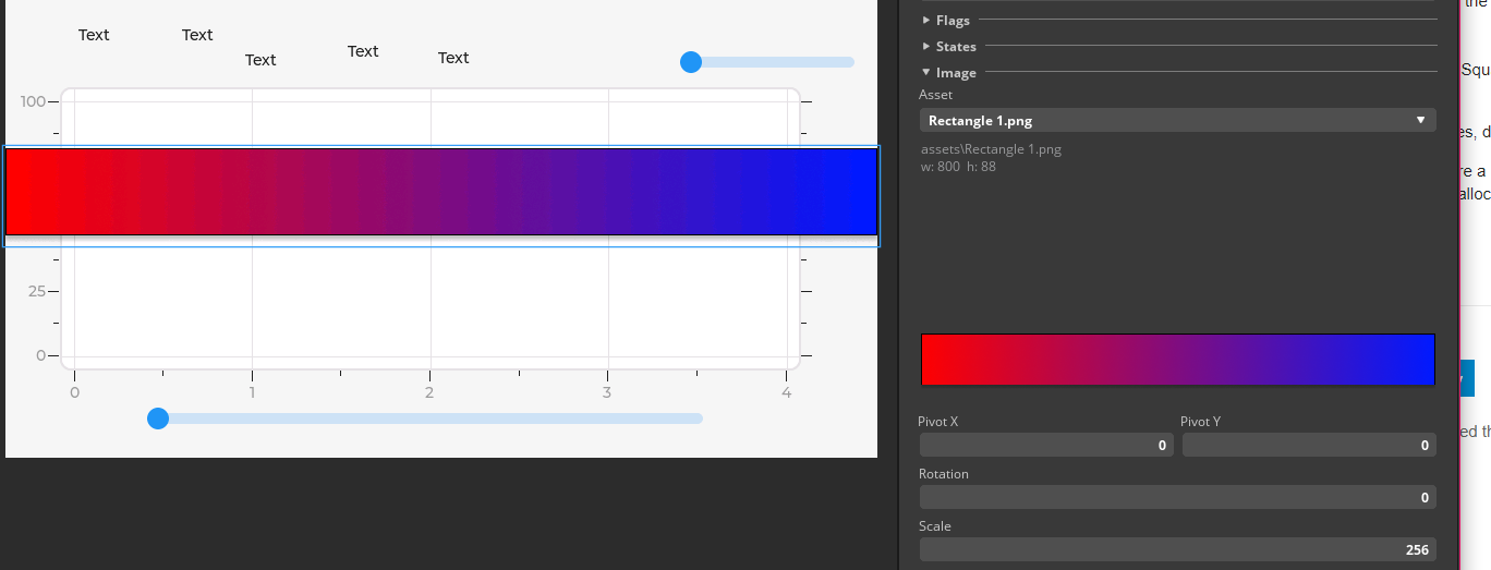

It all compiles fine, touch works great, it’s responsive etc, but i’ve reached a point where adding another widget to the project will freeze the display when the screen is loaded.
There’s no crash on serial, it just freezes.
Working in Arduino IDE: after compilation it shows that the sketch uses 36% of storage and 29% of dynamic memory, so there still seems to be plenty of space left. I have about 50 widgets in total, some transparent pngs, only 1 font.
There is a graph with a temporary 1000 point array but the same issue is observed when the graph is disabled. Adding any more widgets than around 50 freezes the display. Take 1 off, compile and flash, and it works again. Add 1 and it stops working.
Like some kind of limit is being reached.

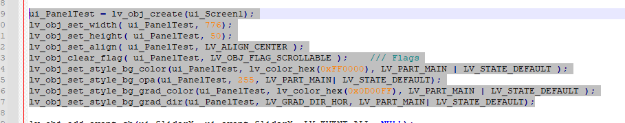

BTW same thing happens whether the widget is added via Squareline or directly by code.
