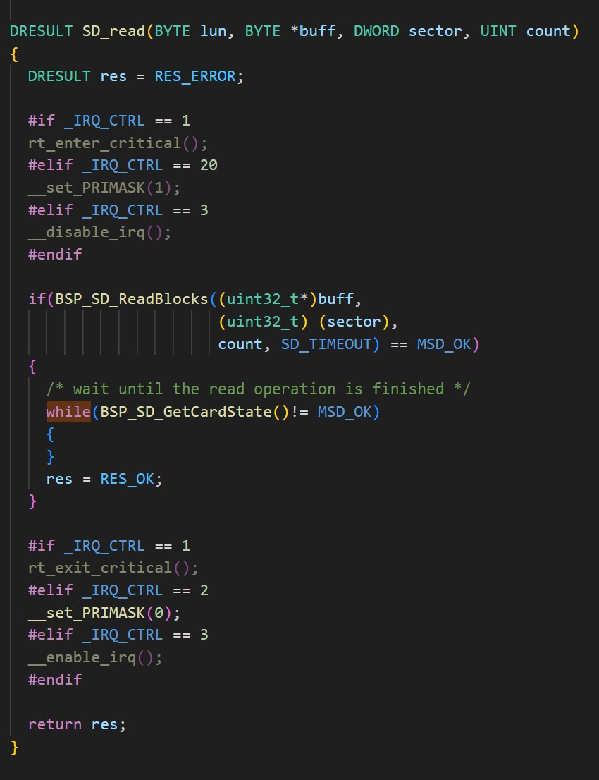

the first trouble i meet was when i use the fatfs to open a gif and play it, it will stuck after the gif play 1-3 minues.
I tried changed the ffconf.h / lv_conf.h / (rtthread)board.c. use 1 file lock/ larger the cache / large the thread heap/ rase the sdio div slow down the clk.
BUT still useless.
The one of solution is raise the priority of the lvgl flush task. like
thread_lvgl_flush_task = rt_thread_create(“lvgl_flush_task”, lvgl_flush_task, NULL, 4096, 8, 1000);
When I debugging i note the programe stuck in the funtion, it belong gifdec.c
so i guess the fatfs might cause some wrong.(like got interrupted while it reading data)
static void discard_sub_blocks(gd_GIF * gif)
uint8_t size;
do {
f_gif_read(gif, &size, 1);
f_gif_seek(gif, size, LV_FS_SEEK_CUR);
} while(size);
Another one solution is plus the “enter critical” when sdio doing io operation,
