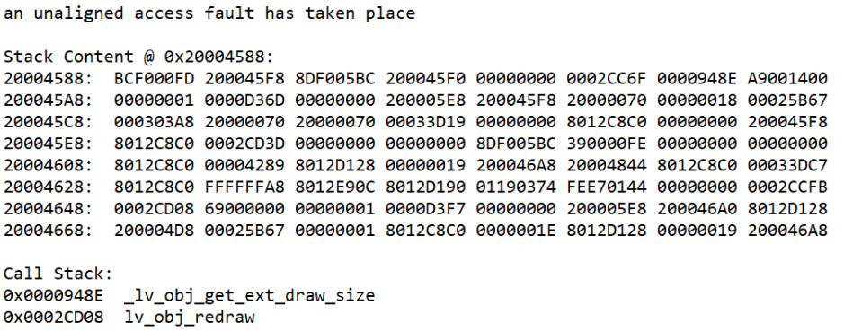

The first animation in the above code executes normally
When the second fault code is executed, a Hardfault fault fault will be reported
The screenshot is as follows:
May I ask what the reason is?
@xxmmtt , I reduce your code like this:
void lv_ex_img_4(void)
    lv_anim_t a;
    lv_disp_load_scr(ui_logo);
    lv_anim_init(&a);
    lv_anim_set_var(&a, my_img);
    lv_anim_set_exec_cb(&a, (lv_anim_exec_xcb_t)lv_img_set_zoom);
    lv_anim_set_time(&a, 2000);
    if(Function_State==ANIM_STATE)
        lv_anim_set_values(&a, 0, 256);
    else
        lv_anim_set_values(&a, 256, 0);
    lv_anim_start(&a);
And you probably need to declare the animation locally, and after repeating the execution, the local address was lost.
