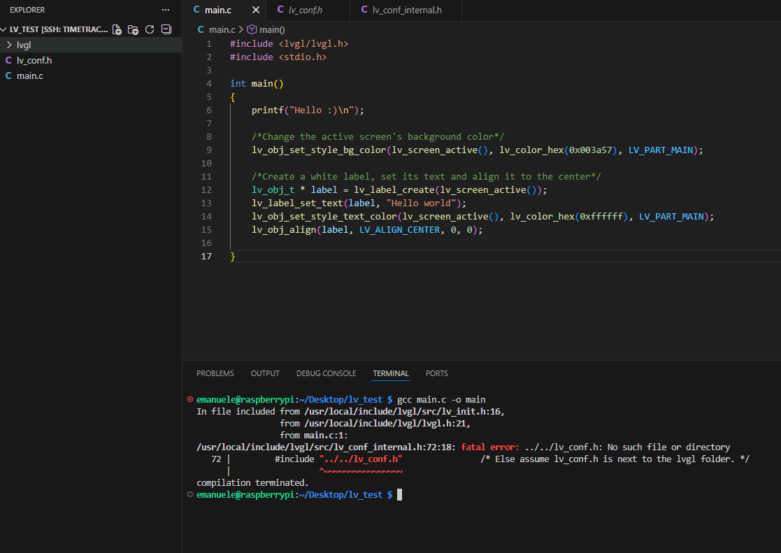

My real issue is that this wont compile properly. I keep getting the error:
/usr/local/include/lvgl/src/lv_conf_internal.h:72:18: fatal error: ../../lv_conf.h: No such file or directory
   72 |         #include "../../lv_conf.h"                /* Else assume lv_conf.h is next to the lvgl folder. */
compilation terminated.
Here is a pic of my IDE with the relevant information mentioned above.

Hi, in order to use LVGL in your project, you need to link your program with it
I recommend using GitHub - lvgl/lv_port_linux: LVGL configured to work with a standard Linux framebuffer to get started as that will also setup any required display drivers for you
