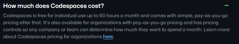

FYI, for the GitHub Codespace , it’s now 60 free hours/month
Amazing! Thank you for shraing it!
