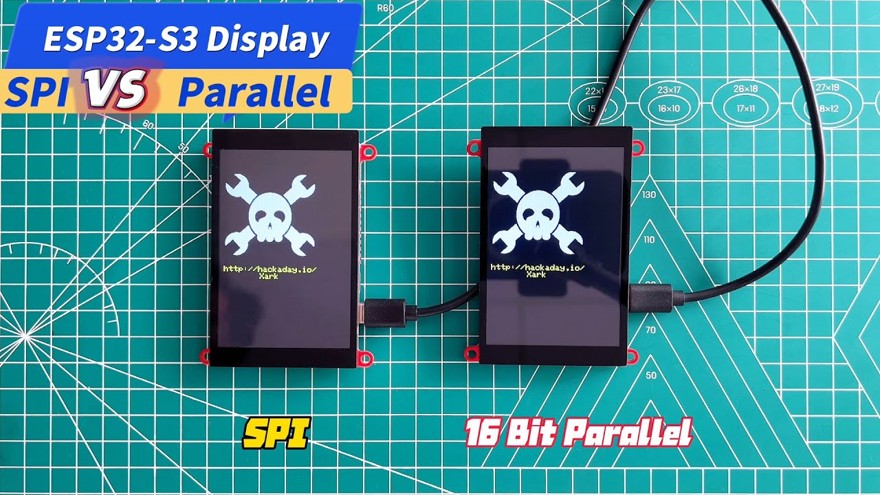

If you would like 480p with SPI communication, it might be very slow, but you can easily use ESP-IDF.
But if you don’t have to SPI communication, than parallel connection is good, but you can’t use ESP-IDF, just only Arduino framework. If you are a beginner and would like to learn about this thing, I think this is the perfect choice.
Little compare video (SPI vs 16 bit parallel):
and why would you not be able to use the ESPIDF if you are using a parallel display?
For a 320 x 480 display running SPI on an ESP32 is actually not that bad…
see here.
That’s running the lv_micropython binding which is going to be slower to some degree than running LVGL without micropython. I am using double buffering with DMA memory and the buffers are 1/10th the display.
Actually, what I said is not entirely true, you can use ESP-IDF if you use LovyanGFX driver. The lvgl_esp32_drivers is not compatible with parallel connection.
