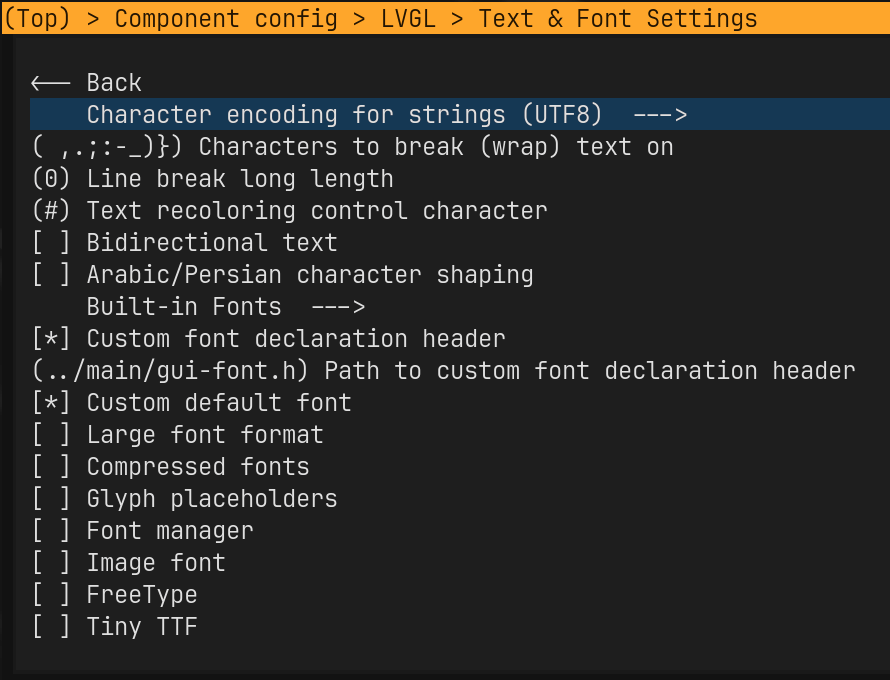

I can confirm it works. And this is the content of main/gui-font.h:
#define LV_FONT_CUSTOM_DECLARE \
        LV_FONT_DECLARE(font_geist_bold_24) \
        LV_FONT_DECLARE(font_geist_medium_20) \
        LV_FONT_DECLARE(font_geist_medium_40) \
        LV_FONT_DECLARE(font_geist_medium_48) \
        LV_FONT_DECLARE(font_geist_regular_20)
#undef LV_FONT_DEFAULT
#define LV_FONT_DEFAULT &font_geist_medium_20
