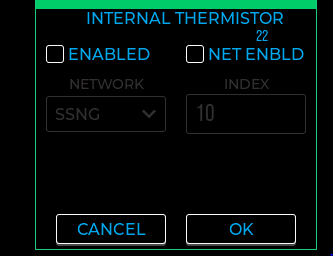

The checkbox on the left is checked and the one on the right is not checked. The border of the indicator is correct, but no check mark.
