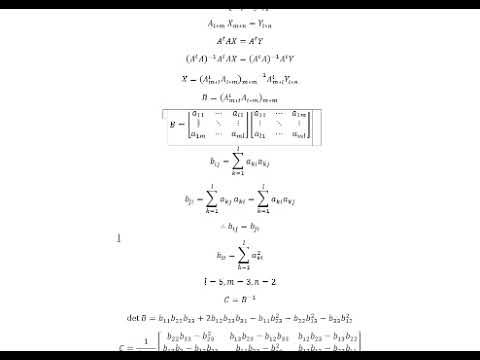

Resistive Touchscreen calibration
Here is the operator process
I will discuss about the code in the future.
The resistive touch screen chip is xpt2046.
