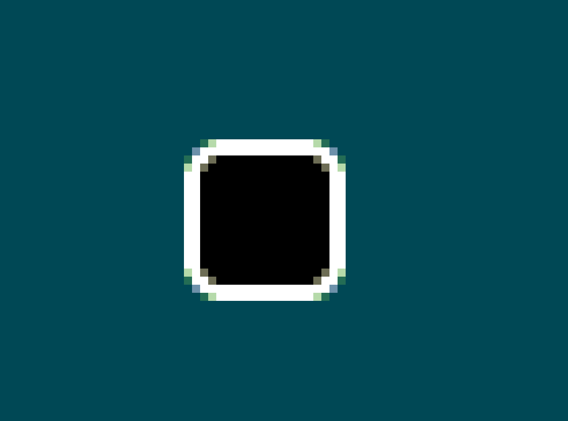

I would like to render widgets without any color smoothing or antliasing. See picture of checkbox.
The code used is here

The screen is rendered to an rgb332 screen at the lv_flush_cb. So any rgb565 color that comes in is made an rgb332 color. This normally works fine but the color smoothing sometimes looks bad and I want to avoid and CPU hit from it. I would like to completely remove color smoothing. Based on other posts I’ve been led to believe that the lv_display_set_antialiasing should do this, but it does not.

Zoomed in, you can see the strange colors. I just want white, black, and 0x004040 in this picture, none of the greens/greys/blues.
