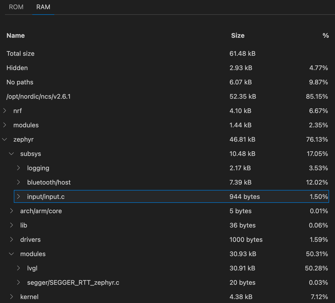

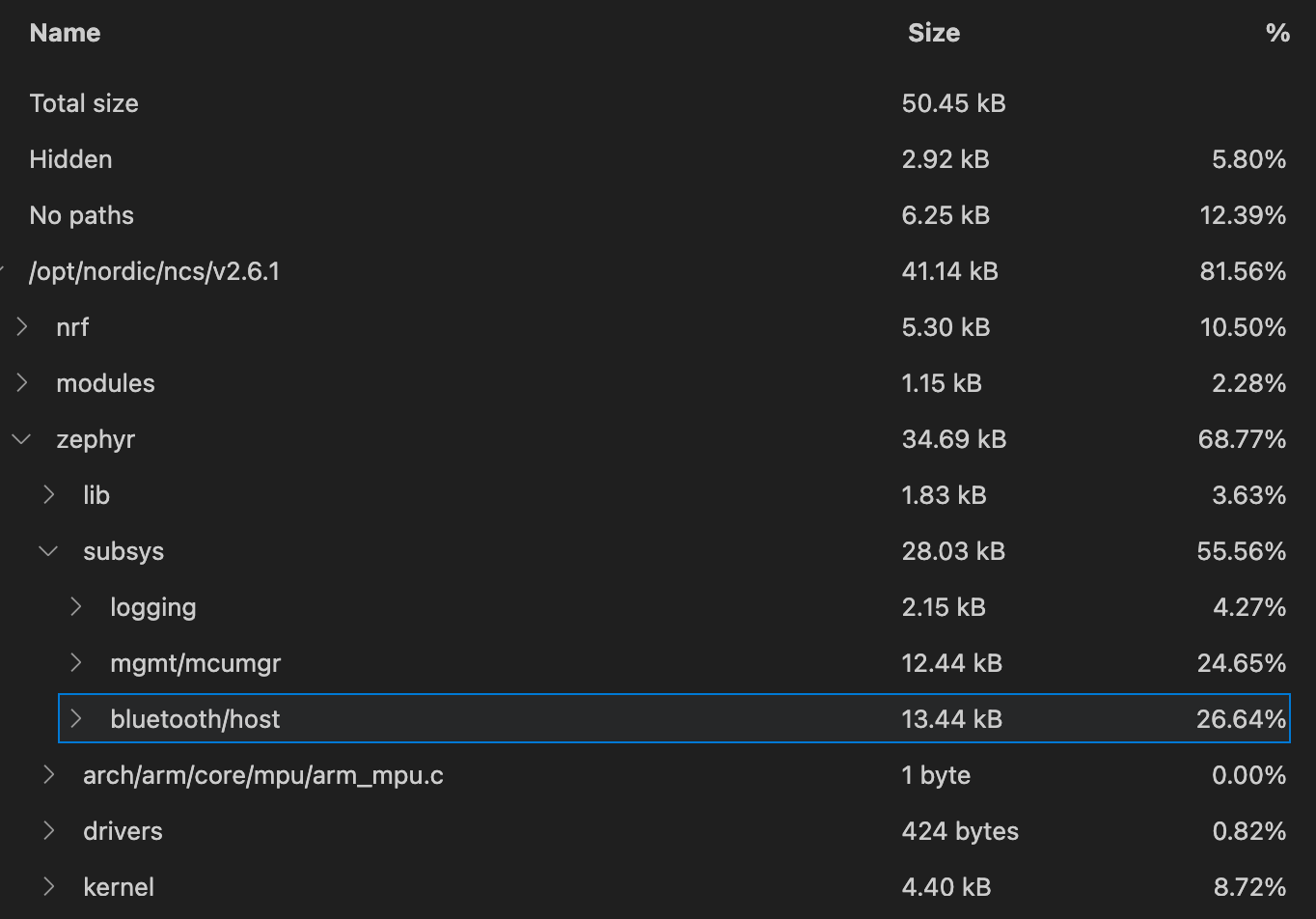

This is the RAM memory report for the MCUBoot build
This is the RAM memory report for the lvgl build:
