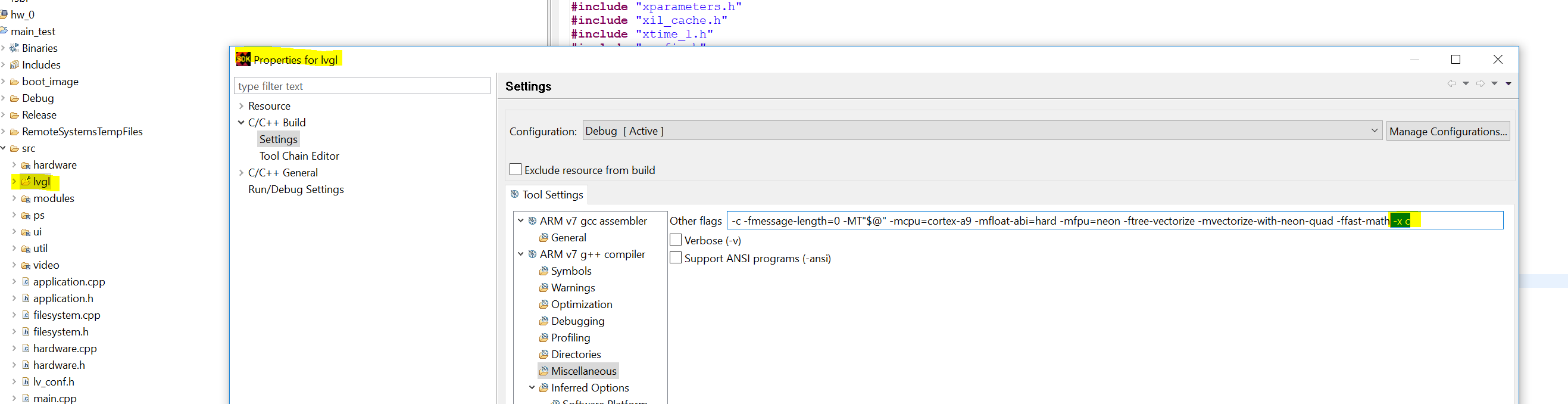

Well y’all led me to the answer, in any case!! Adding a “-x c” compiler flag to the lvgl folder has resolved the issue. Screenshot attached for future reference if any Xilinx SDK issues pop up:
