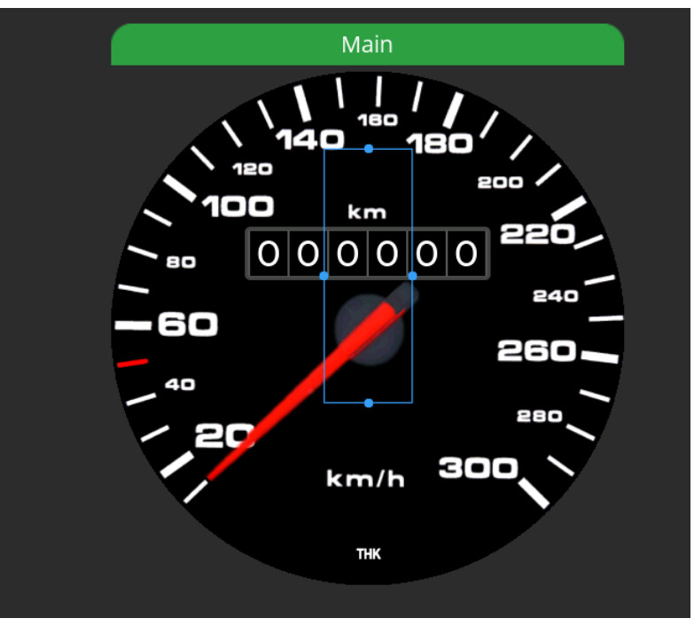

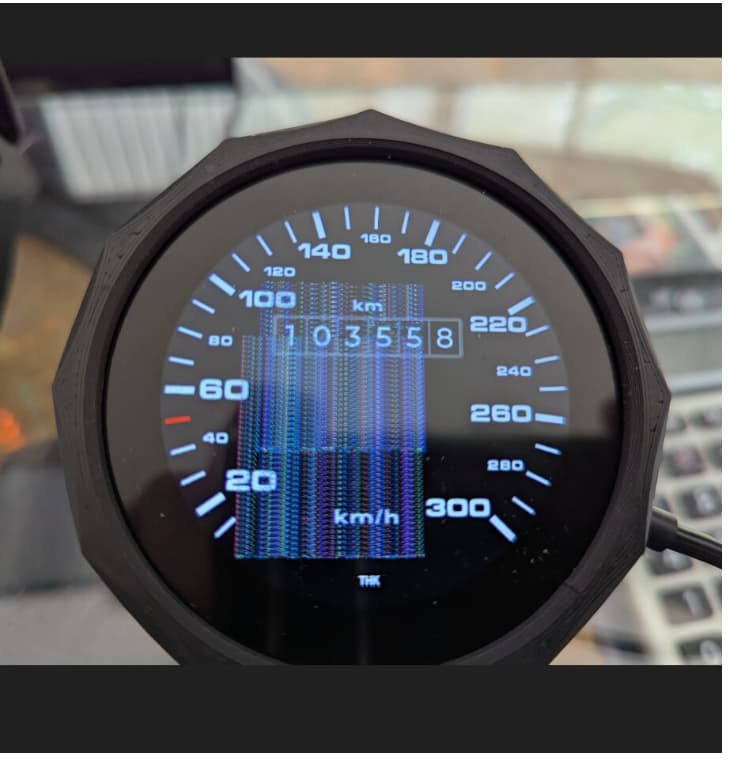

Png file distorted display in LVGL 9.2.2
Proper display of a png file in image widget in 9.2.2, which was properly working with LVGL 8.3.9
Copied and re-saved the file, tried various parameters like rotation, scale - no change
Exported several times and re-compiled - no change.
Screenshot or video
Display in SLS 1.51
Display on ESP32-S3
Others
LVGL 9.2.2

I have found the bug, it was a new setting in lv_conf.h, which was missing:
 * Selectively disable color format support in order to reduce code size.
 * NOTE: some features use certain color formats internally, e.g.
 * - gradients use RGB888
 * - bitmaps with transparency may use ARGB8888
#define LV_DRAW_SW_SUPPORT_RGB565		1
#define LV_DRAW_SW_SUPPORT_RGB565A8		1
#define LV_DRAW_SW_SUPPORT_RGB888		1
#define LV_DRAW_SW_SUPPORT_XRGB8888		1
#define LV_DRAW_SW_SUPPORT_ARGB8888		1
#define LV_DRAW_SW_SUPPORT_L8			0
#define LV_DRAW_SW_SUPPORT_AL88			0
#define LV_DRAW_SW_SUPPORT_A8			0
#define LV_DRAW_SW_SUPPORT_I1			0
