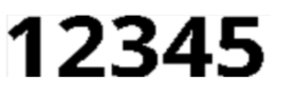

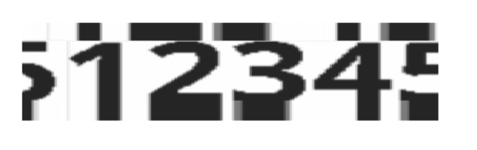

I am trying to do pinch to zoom the bitmap image. While trying to zoom the image I found that image is not zooming but it is stretching and it is repeating the image content after zooming
This is the normal image:
After zooming:
