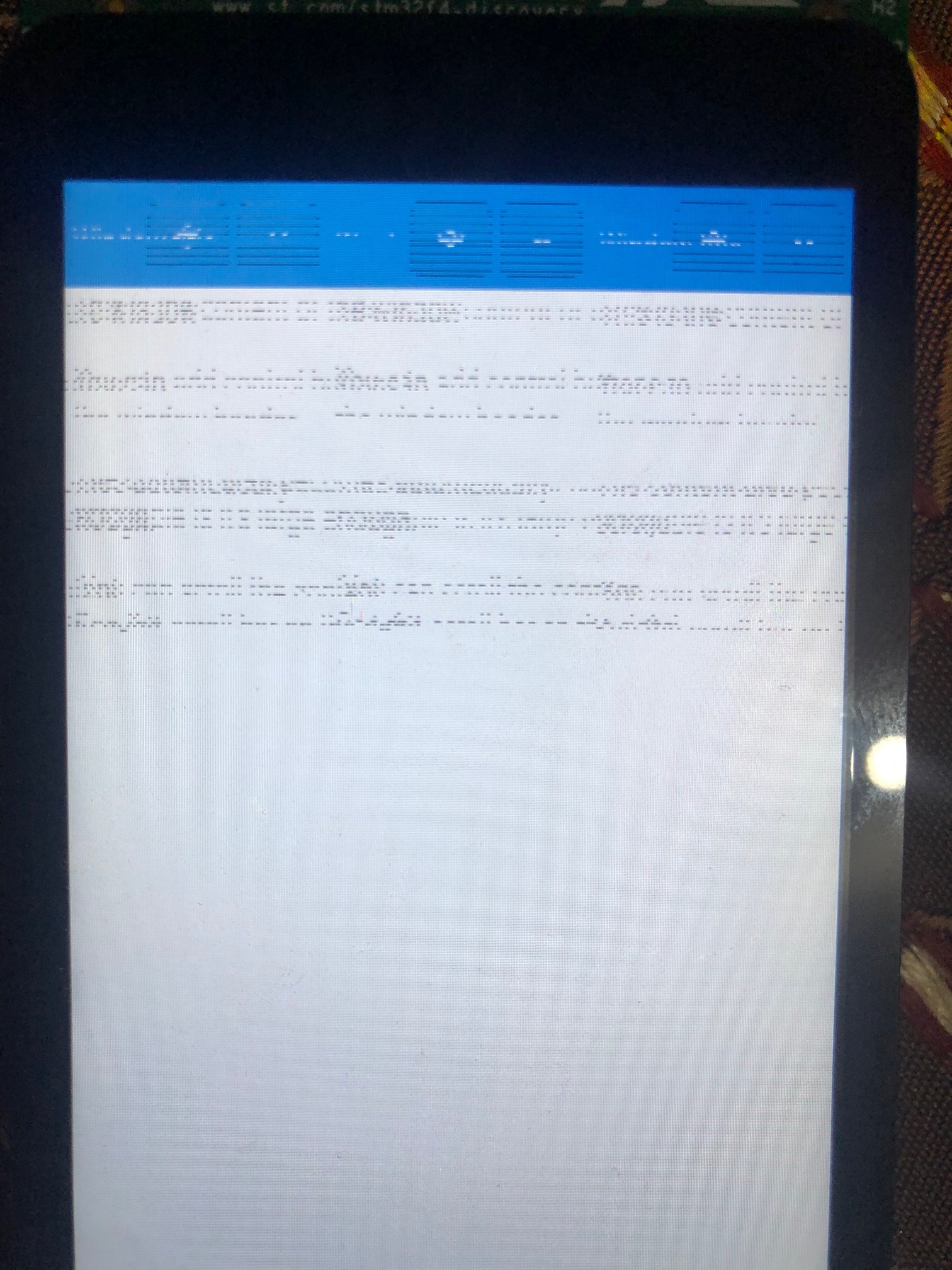

hi, i trying to change the orientation to portrait of lcd but not successful, i had test the base code in landscape and it’s working well. below is the mention source code that i had changed to make it working in portrait view. by doing it it show the window in portrait view but with rough view. image is attached

Try to switch horizontal and vertical size. I had the same issue first time i did used the library with an esp32 in tft.h hor 800 vert 480
thanks issue is fixed by below
  • @file lv_conf.h
  • COPY THIS FILE AS lv_conf.h NEXT TO the lvgl FOLDER
#if 1 /Set it to “1” to enable content/
#ifndef LV_CONF_H
#define LV_CONF_H
/* clang-format off */
#include <stdint.h>
Graphical settings
/* Maximal horizontal and vertical resolution to support by the library.*/
#define LV_HOR_RES_MAX (480)
#define LV_VER_RES_MAX (800)
