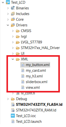

Hi, I am testing an example from the XML section: lv_example_xml_2.c.
However, I cannot open the XML file even though it has been added to the project.

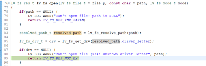

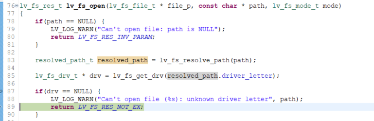

I encountered an error in the lv_fs_get_drv function inside lv_fs_open.

Hi @truongvanvuembedded ,
The lv_xml_component_register_from_file() API you are using is no longer available in LVGL 9.5 . The XML runtime loader has been removed from the open-source core of LVGL.
