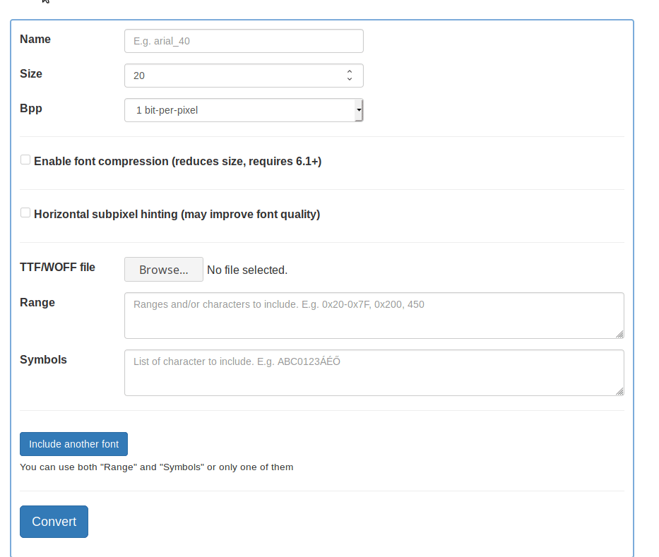

And also screenshot about the configuration of the online converter.

I’ve also tested in an other browser and it worked. Here is what I did:
