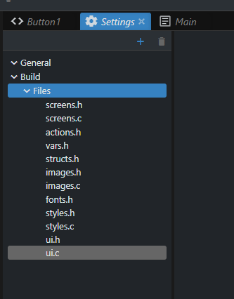

In the project that is generating those files, you can check in settings if those files are included in the Build.
If they are in the list, you can try to add them in your new project (and copy the content to the new project).
