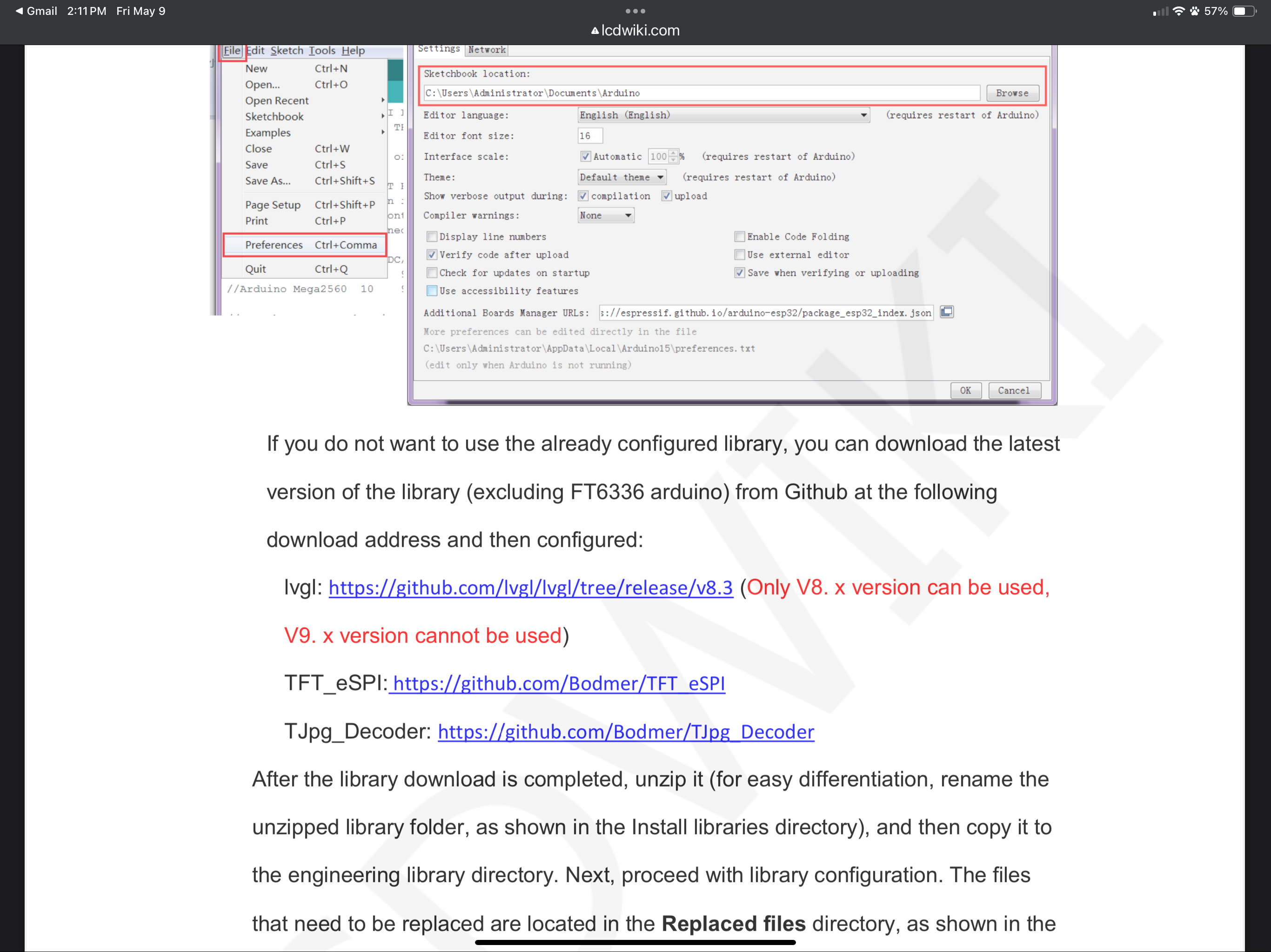

Need help, cannot get lvgl to work, screen all random rgb pixels
I’ve got an ESP32 DevkitC and Hosyond 4.0 touch screen. I have zero issues getting the display the function using either TFT_eSPI or Adafruit GFX. My issue lies in the implementation of lvgl. as soon as i attempt to use it, i get a screen full of random color rgb pixels. Doesn’t matter if it’s using the tft or gfx library. I’ve gone over lv_conf.h and user_setup.h many times but I’m just not understanding the problem. I’ve been trying to use AI to help solve this but both ChatGPT and Gemini pretty much refuse to use v9 in their responses which is frustrating to say the least. I’ve tried using the ST7796 driver and the ILI9488 and both have the same result. It compiles and uploads just fine.
Arduino IDE 2.3.6
ESP32 DevkitC Amazon.com: AITRIP 2 Sets ESP-WROOM-32 ESP32 ESP-32S Type-C USB Development Board Type-C USB CH340C WiFi+Bluetooth Ultra-Low Power Dual Core ESP32-DevKitC-32 ESP-WROOM-32 Expansion Board for Arduino : Electronics
Hosyond 4.0" Touch Screen Amazon.com: Hosyond 4.0 Inch 320x480 TN Capacitive Touch Screen LCD Display Module SPI Serial ST7796S Driver for Arduino R3/Mega2560 : Electronics
LVGL 9.2.2
Put a label on the screen
Everything. I highly prefer to solve issues myself but I’m at a total loss and have been stuck on this for more than 80 hours. I haven’t found any issue like this on any forums to use as a reference. I must be doing something very basic wrong.

Based on my experience and research, LVGL 9 will not run on the Hosyond 4.0 touch screen. I’m using a genuine Espressif ESP32-S3-DevKitc-1 with the Hoysond 4.0 touch screen and tried for weeks to get LVGL 9.2 to work with these (probably close to 80 hours too). I finally went back to LVGL v8.4 and got it to work with the ST7796 drivers.
For the board in the Arduino IDE, I’ve selected the OLIMEX ESP32-S3-Devkit-lipo (it is the only one I’ve found that seems to work with my ESP32 board.
By chance have you tried the demo from Hoysond for LVGL, if not, I would start there. Note that it is LVGL 8.x.
First, be sure that you’ve copied the lv_conf.h file so that it is at the same level in the folder structure as the LVGL folder, e.g., - however your development environment is setup, it might look like this:
Arduino
  • Libraries
    • LVGL
    • lv_config.h
    • TFT_eSPI
    • etc…
Next is getting your pin settings configured for the Hoysond 4.0 touch screen. This was the most challenging for me. Here is my User_Setup.h file with the pins I’ve used.

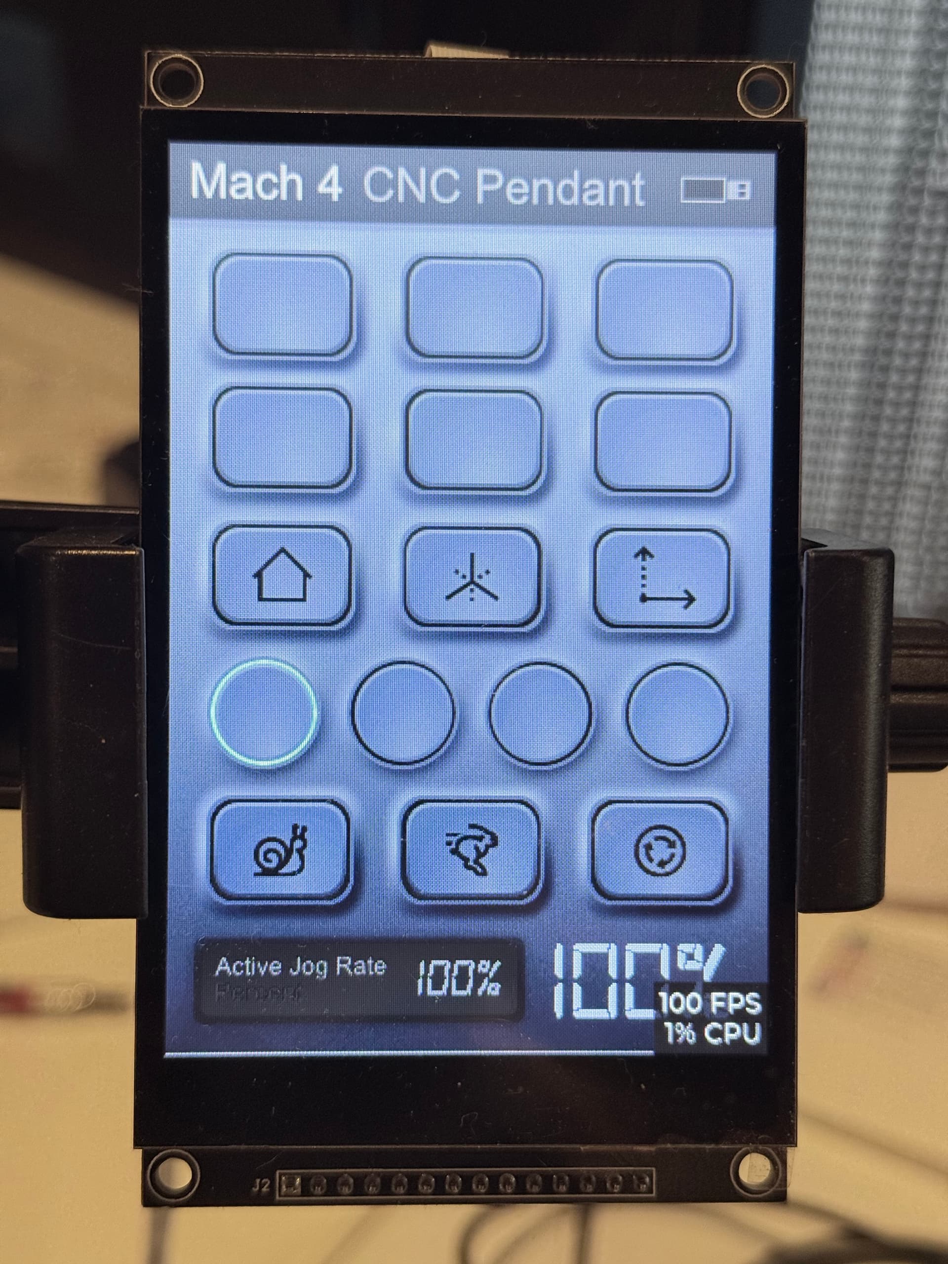

For my project, I’m building a CNC MPG pendant for Mach 4. For the GUI, I’m using Affinity Designer 2 and exporting the graphics to use with Squareline Studio.
To follow up, here is what the documentation says for setting up LVGL:
Link to documentation: http://www.lcdwiki.com/res/MSP4030_MSP4031/4.0inch_SPI_MSP4030_MSP4031_ESP32_Demo_Instructions_EN.pdf
so I WAS able to get it to work with v9… I literally created a super basic, stripped down version of the lv_conf file, only including the settings I needed, deleting the rest. So there must be something wrong in the rest of the ‘bloat’ because NOT having those non-functional settings did it. This is what it looks like now:
