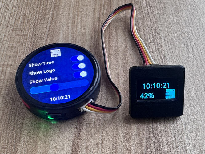

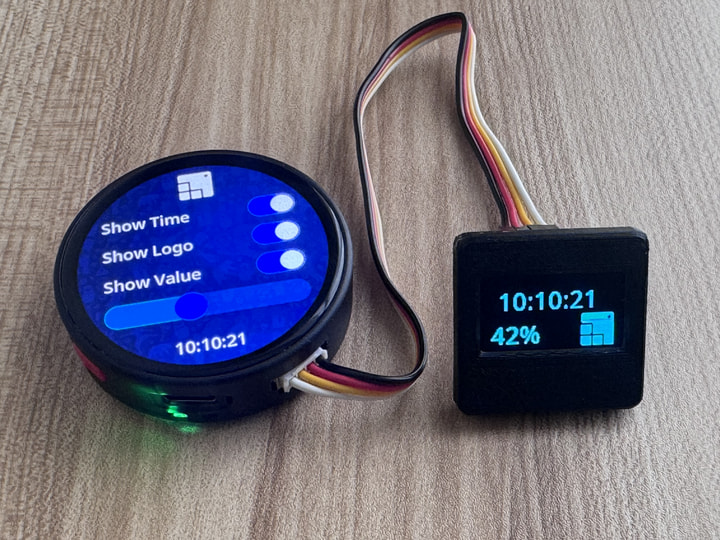

Take a look at this project
though its LVGL v9 & PlatformIO
