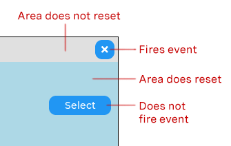

I’m using LVGL v9 for a little windows utility. I implemented WindowProc successfully and I got everything running except PRESS_LOST in button logic for when a button is pushed but then cancelled by moving the cursor away from the button.
For the titlebar close button I can successfully get the PRESS_LOST event to fire but the button remains in limbo. I need to click any button twice after to reset the button states and make them work again. How do I properly reset the button states?
One additional tidbit… if i move the cursor over ‘cont’ and release it will reset the button states as expected.
For the select button in my content widget (cont) I cannot get PRESS_LOST to fire and the click will be executed no matter where on screen I release the press.
Too many to list and I have too little inner knowledge of LVGL to figure this out in a reasonable time.

Screenshot
lvgl_problem
  • Win10:
  • LVGL version: v9.3
