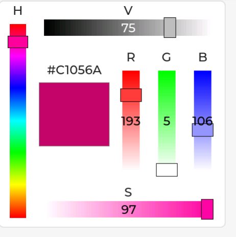

Another idea.
Screenshot 2026-07-27 23.12.06
