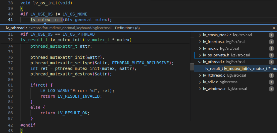

The drawing task uses mutex too, on the implementation of lv_mutex_init() it passes the global mutex to the choosed OS implementation:
So as long you are using lv_lock() and lv_unlock() while interacting with lvgl objects you should have no problem.
