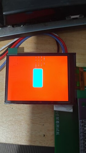

Lvgl screen with stripes and distortion
I tried modifying the disp_flush function, but it still didn’t work; it only works correctly when displaying solid colors.

  • MCU/MPU/Board:
  • LVGL version: See lv_version.h
    mcu:at32f407avgt7
    lvgl:9.1
    screen:st7789V2,8bit parallel port
In your code above, I noticed this line: if(disp_flush_enabled) {. Could you explain what it does?
I also saw that your code on GitHub is currently in a .rar file. It would be much easier to review if the actual files were available directly on GitHub instead of in a compressed archive.
