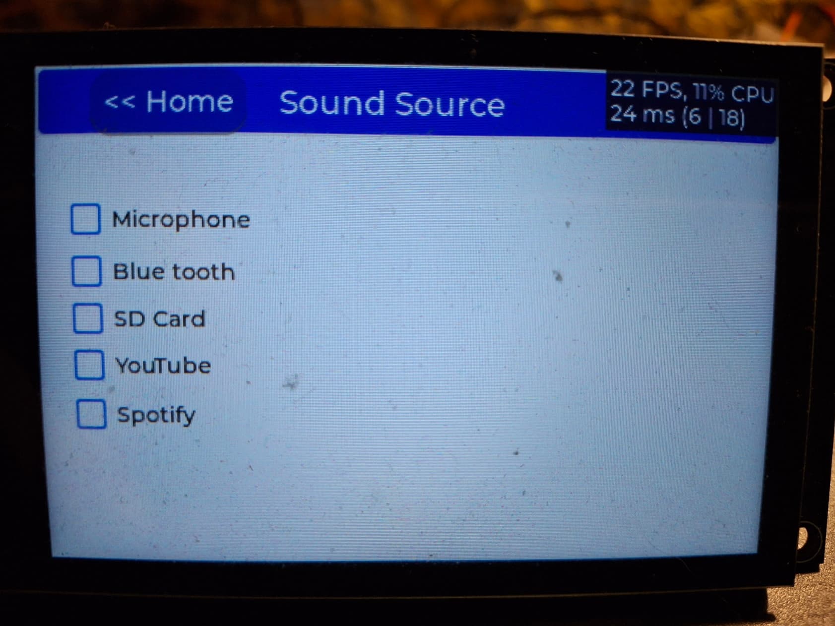

LVGL radio button (checkbox) group
I am attempting to have a group of radio/checkbox items whereby if one is selected the remaining will be deselected and have a handle on the selected item
Attempted to use the process outlined in LVGL docs Checkbox (lv_checkbox) — LVGL documentation but that code may be fine on a stand alone but not in the EEZ studio page framework
/*You code here*/
void action_set_source(lv_event_t *e) {
int * lv_checkbox; // create a user data type pointer
lv_checkbox = (int*)lv_event_get_user_data(e); // cast the return pointer to data type pointer
//printf("btn no. %d \n", * lv_checkbox); // use the pointer value…
//printf("user data is %d\n", lv_checkbox);
if (lv_checkbox != NULL) {
    if (*lv_checkbox == 1)
        printf("on one");
    else{
        printf("who knows on one");
} else {
    printf("no user data\n");
} << causes a reboot (bad code)
  • MCU/MPU/Board: ESP32 dev module 8 meg
  • LVGL version: 9.4

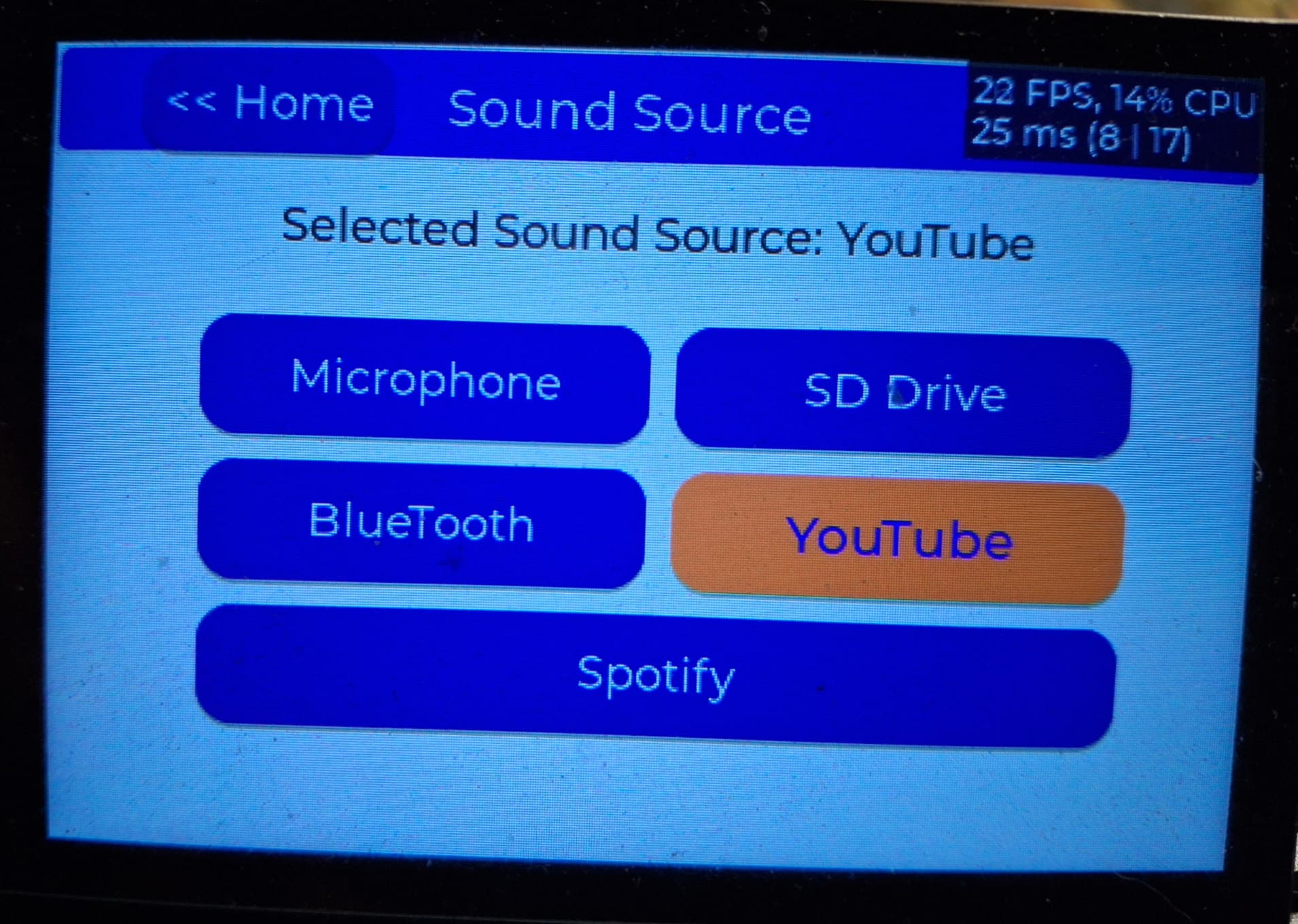

I could not make this work within the framework of EEZ Studio no matter how many times I tried (looks like a bug). I changed over to a button matrix. With a huge modification to the code, I was able to achieve this" If anyone is interested in the code, reply to this post
