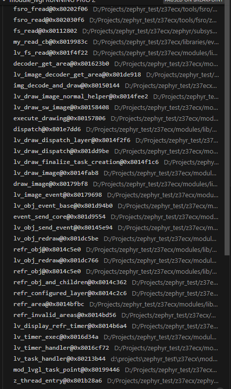

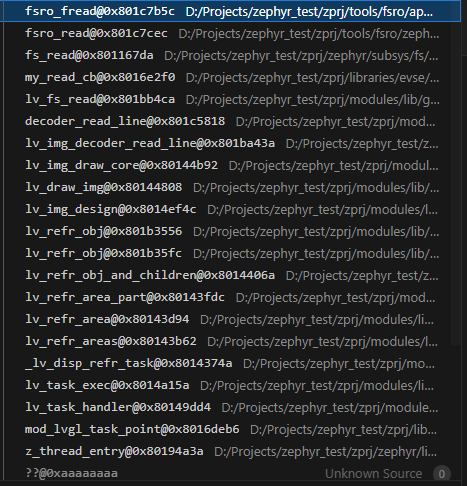

Сall stack when accessing bmp-file contents in v7.6 looks like
Сall stack when accessing the same file in v9.3
All data - OS heap, LVGL heap, files content - are stored in external SDRAM, accessing via SEMC.

v7.6 lv_img_design() located in src\lv_widgets\lv_img.c execution time accessing bmp-file 768x689 - 25.1ms
v9.3 draw_image() (as far as I understand this function has the same purpose as lv_img_design() in v7.6) located in src\widgets\image\lv_image.c execution time accessing the same bmp - 51.5ms.
