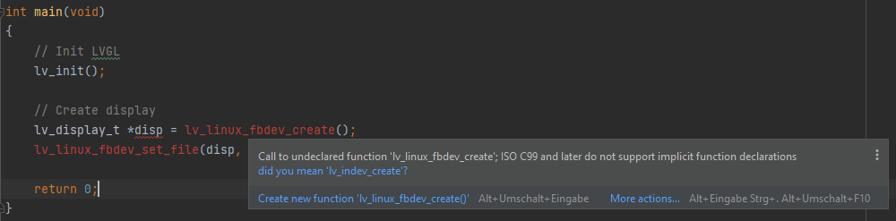

Im new to LVGL and Im currently trying to set it up. I want to develop an application for my RPI4 which should run on a linux framebuffer. Im currently using CLion with an SSH Remote Project to develop the project.
Im currently trying to create a simple HelloWorld program but Im failing at including the framebuffer driver correctly. All its functions (e.g. ‘fbdev_init()’, ‘lv_linux_fbdev_set_file’…) are marked as undeclared even tho I included ‘fbdev.h’ and CMake does not output any errors.
My source code is on my host machine (Windows 10) and CLion syncs it with my RaspberryPi 4. It executes CMake and compiles on the RPI.
I want to start working with LVGL and Im trying to create a simple HelloWorld project which is displayed on a linux framebuffer (which is displayed on a GC9A01 connected via SPI).

Here is a screenshot of the error Im getting. IntelliSense doesnt even suggest the fbdev functions so it doesnt find them at all…

What I just realized: My functions are marked as not declared but the app does compile and run. Seems like its an issue of CLion.
