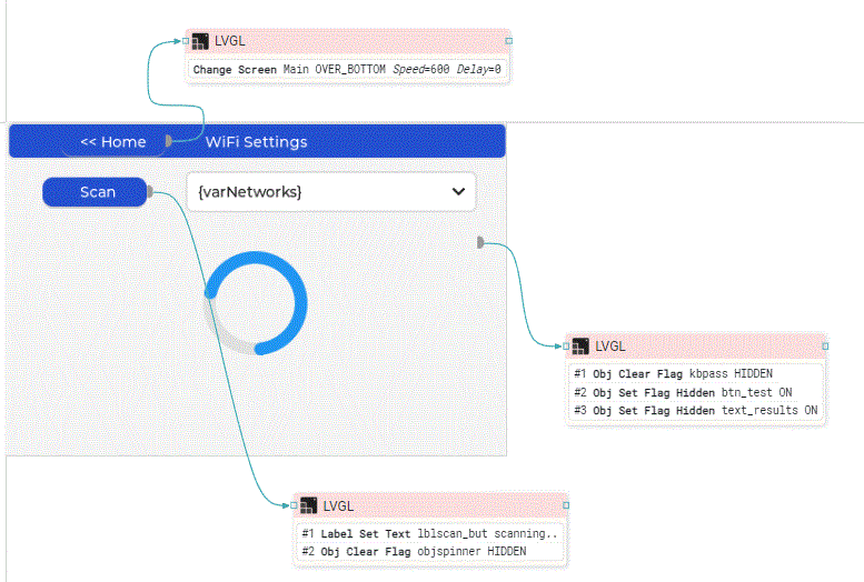

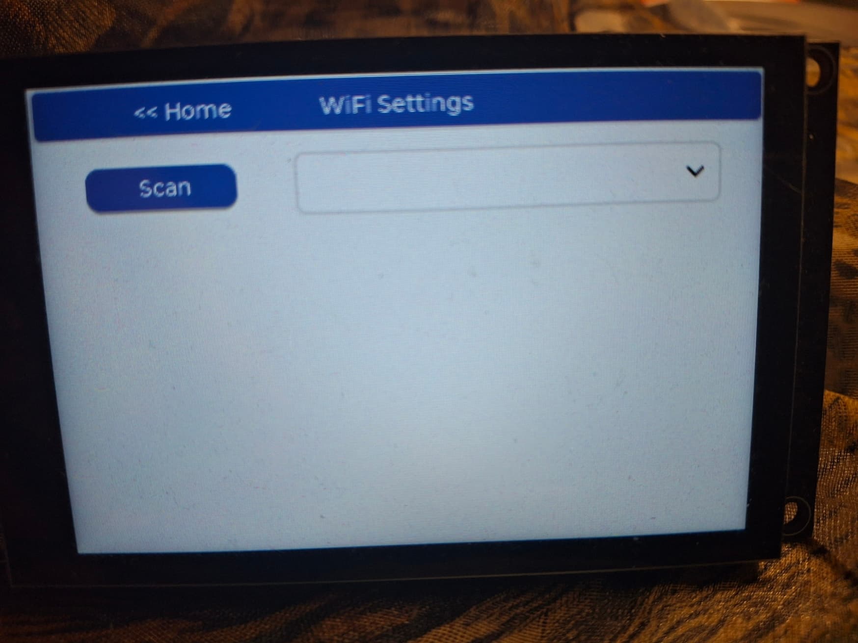

Pressing the Scan button calls the lvgl function “btnScanNetwork”
void action_btn_scan_network(lv_event_t *e) {
if (e == NULL) {
Serial.println(“Event is null”);
} else {
Serial.println(“Event is not null”);
set_var_var_networks(ScanWiFi().c_str()); (a call to grab all the WiFi networks, update the lvgl variable var_networks. The options of the dropdown are from that variable )

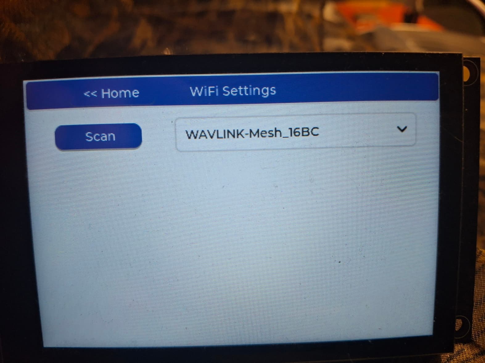

This works to a point. no other lvgl events take place, the Serial.println(“Event is not null”); doesn’t work, the counter stops incrementing (loop is not returned to)

Regarding the event, you don’t see the print Serial.println(“Event is not null”);? seems strange since in your picture the dropdown is populated. Maybe some quirk of the function, i think this doens0t write immediately to serial port but stores data to be sent via DMA/IRQ (but may be very wrong about this)…
