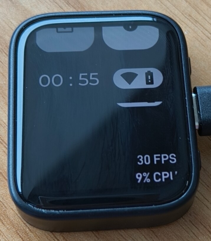

LVGL frequently freezes when scrolling up and down
Solve the freezing problem, when i keep scrolling up and down the screen, eventually it’ll freeze. I’m using the gesture event to do the scrolling.
Several code changes, but none of them solves
