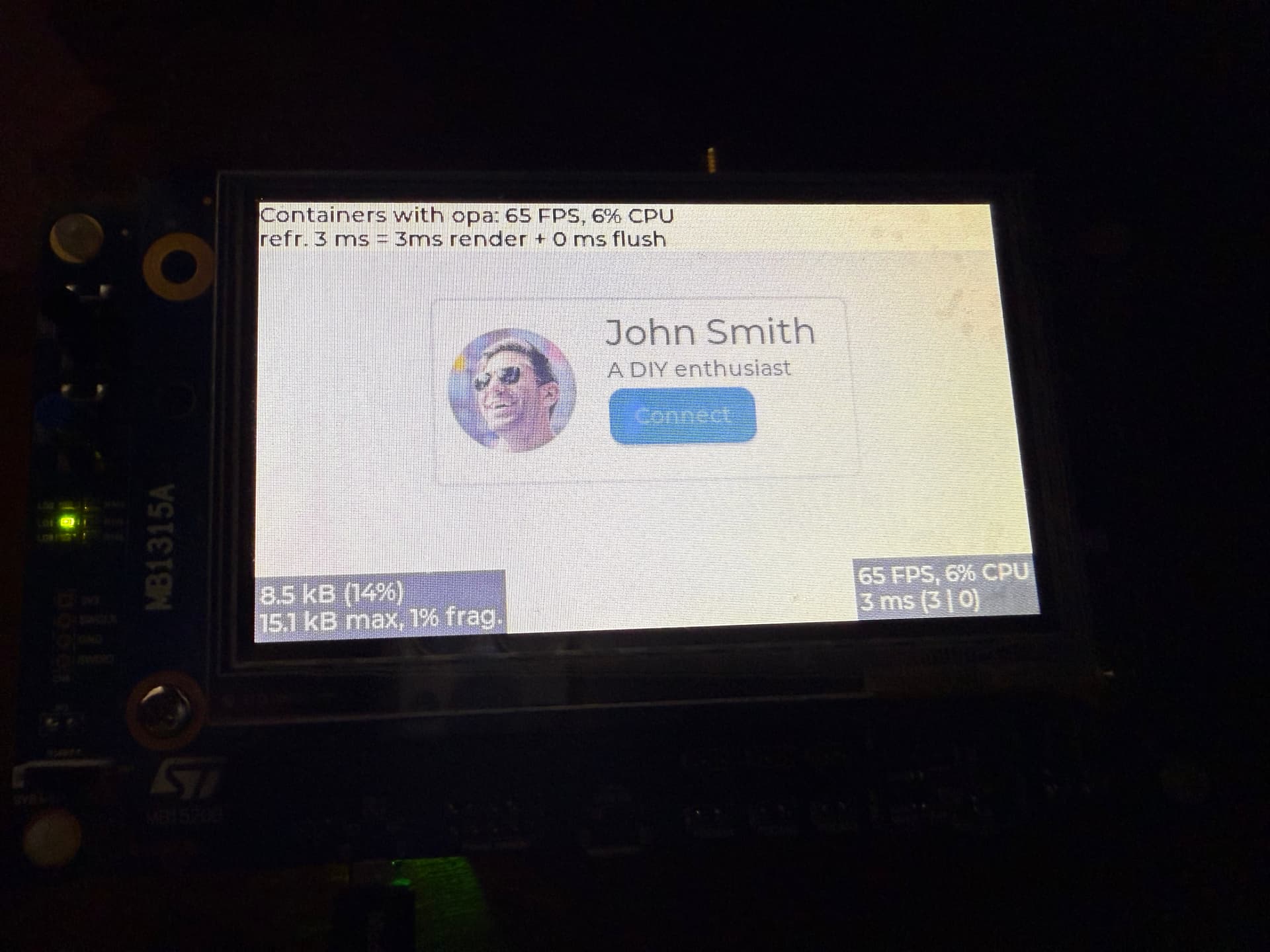

I ported LvGL V9 latest version to my STM32H735IG-DK. Everything is working at I setup. However, once I launch the benchmark demo, the LvGL crashes and stops on this part of the benchmark test:
The benchmark won’t go beyond this.
