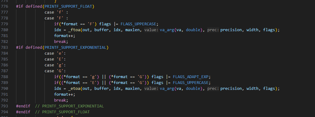

In my test, using v9.5, the only thing required was to change the LV_USE_FLOAT define #define LV_USE_FLOAT 1 in lv_conf.h, no more code changes where required.
If I do that, and open the file lvgl\src\stdlib\builtin\lv_sprintf_builtin.c on lines 776~794 i see in the IDE that the code is no longer “disabled” and lv_label_set_text_fmt works with %f ov lv_snprintf.
Do you have this enabled in lv_conf, to use the builtin implementation?
If using the standard lib, make sure you have enabled float support on compiler definition, since it may be optional depending on the compiler library in use…
