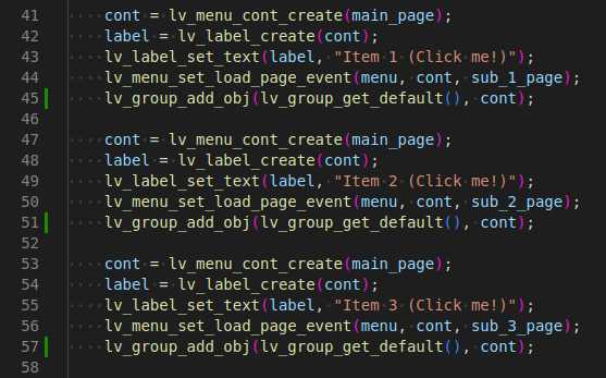

To get lv_example_menu_3 to work, add these lv_group_add_obj(lv_group_get_default(), cont)

Added it. The focus appeared, but after switching to the nested menu, I cannot return to the parent menu, e.g. there is no a focus on the item in the red circle.
not_focused
