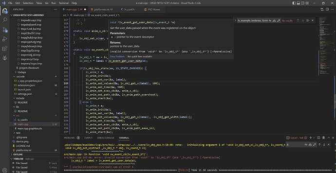

When trying to load examples into platform IO from LVGL, I’m getting conversion errors when I try to compile, specifically with function lv_event_get_user_data() invalid conversion from ‘void*’ to ‘lv_obj_t*’ {aka ‘_lv_obj_t*’} [-fpermissive].
WT32-SC01 (ESP32) / PlatformIO through VS Code
8.3.2
Utilize lv_event_get_user_data correctly, prevent invalid conversion from ‘void*’ to ‘lv_obj_t*’ {aka ‘_lv_obj_t*’} [-fpermissive] errors
Compiling other examples that this error isn’t flagged / doesn’t use the get_user_data() function. It compiles and works as expected on my hardware.

static void sw_event_cb(lv_event_t * e)
lv_obj_t * sw = lv_event_get_target(e);
lv_obj_t * label = lv_event_get_user_data(e);
