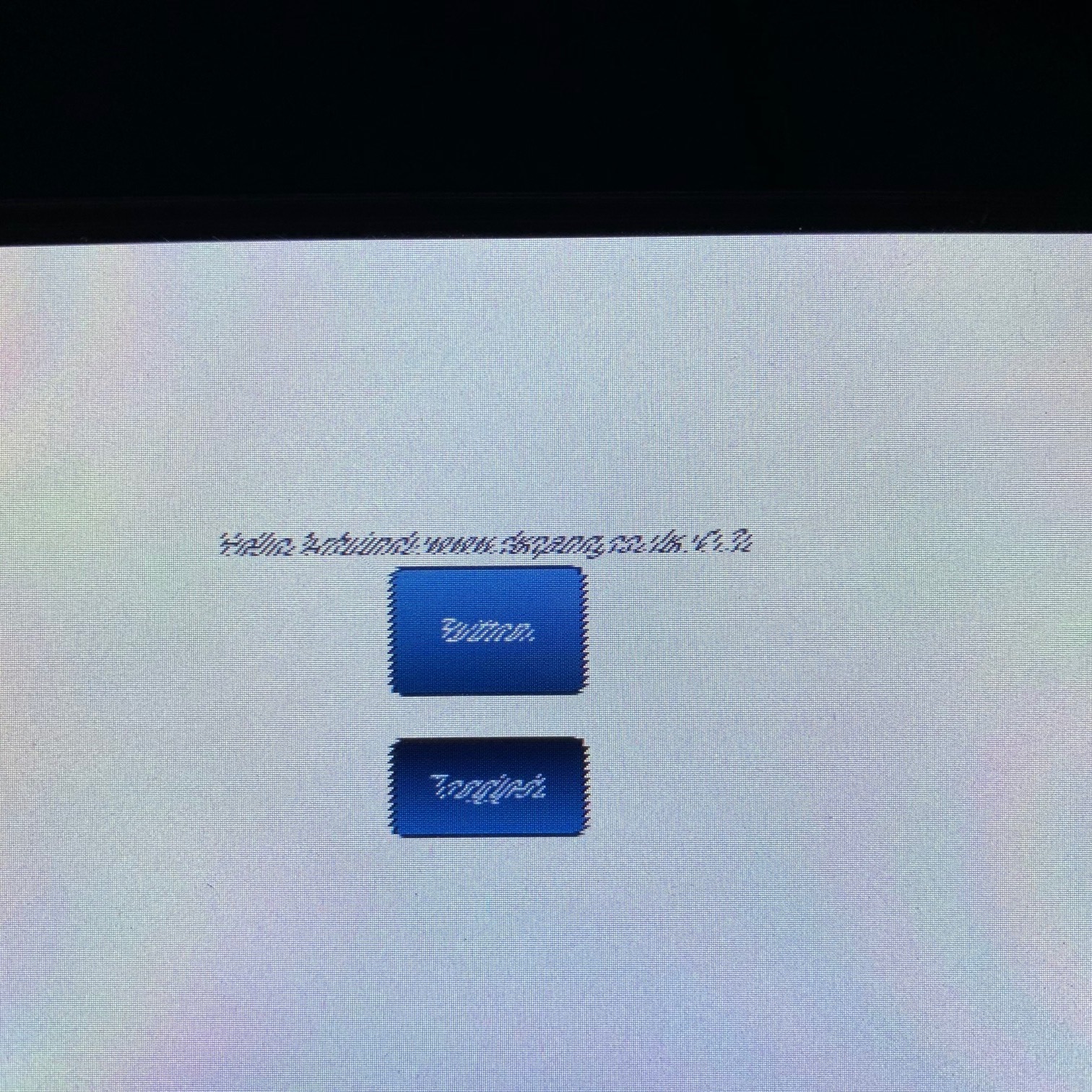

I almost got it to work. In display flush I have:
/* Display flushing */
void my_disp_flush(lv_disp_drv_t *disp, const lv_area_t *area, lv_color_t *color_p)
uint16_t width = (area->x2 - area->x1 +1);
uint16_t height = (area->y2 - area->y1+1);
display.drawPixels((uint16_t )color_p, (width * height), area->x1 , area->y1);
lv_disp_flush_ready(disp); /
tell lvgl that flushing is done */
but the display looks corrupted by a few pixels.
Any idea of how to fix this ?

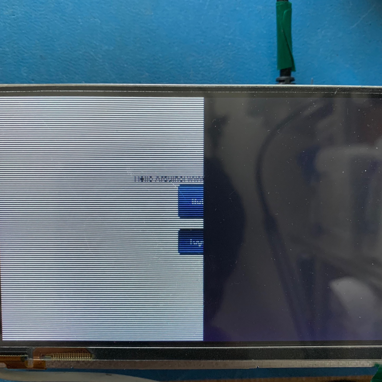

I think it is expecting pixel but I’m sending it bytes count. So I’ve tried to / 8 like this:
display.drawPixels((uint16_t *)color_p, (width * height / 8 ), area->x1 , area->y1);
and I only get half the screen and it looks like it is skipping a line but the text is not slanted anymore.
The calculation is still wrong.
With your original code your width value may have been off-by-one. That usually results in slanted rendering.
