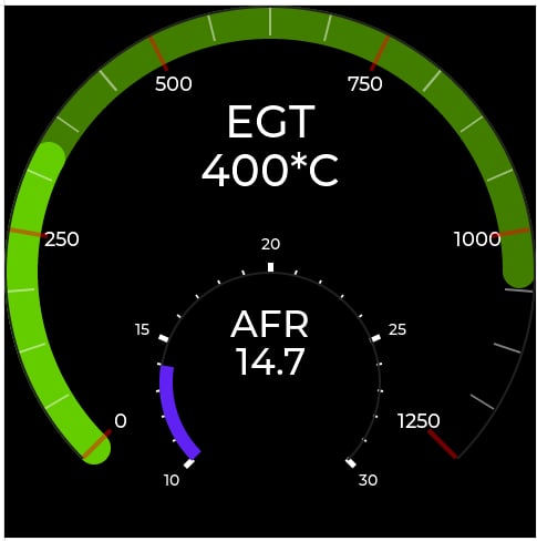

Hello,
Im currently creating a project for a gauge to be fitted into my car.
I have a question is it possible to limit the scale length?
Like in the picture I would like the big scale to end where the arc ends.
Hello,
@dynfer. yes it’s possiable.
You need to change the object style.
lv_obj_set_style_length(scale, 5, LV_PART_INDICATOR)
lv_obj_set_style_length(scale, 5, LV_PART_ITEMS)
Please check the documentation.
