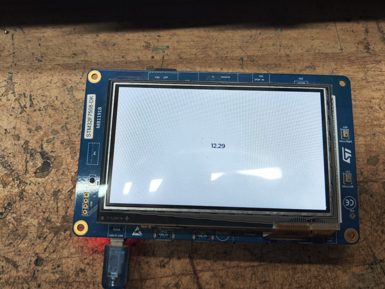

In my version 8.3 it still works fine, try using my code
void test_float_value(void) {
lv_obj_t *obj = lv_obj_create(lv_scr_act());
lv_obj_set_size(obj, 480, 272);// full size
// lv_obj_set_style_bg_opa(input_obj, 0, 0);
lv_obj_set_style_border_opa(obj, 0, 0);
lv_obj_set_style_shadow_opa(obj, 0, 0);
lv_obj_set_style_radius(obj, 0, LV_PART_MAIN);
lv_obj_clear_flag(obj, LV_OBJ_FLAG_SCROLLABLE);// disable scroll
float volume = 12.29;
// Update volume and flow values to screen
lv_obj_t *label = lv_label_create(obj);
lv_label_set_text_fmt(label, "%0.2f", volume);
lv_obj_set_style_text_font(label, &lv_font_montserrat_14, LV_PART_MAIN);
lv_obj_align(label, LV_ALIGN_CENTER, 0, 0);
in the lv_conf.h
#define LV_SPRINTF_CUSTOM 0
#if LV_SPRINTF_CUSTOM
#define LV_SPRINTF_INCLUDE <stdio.h>
#define lv_snprintf snprintf
#define lv_vsnprintf vsnprintf
#else /*LV_SPRINTF_CUSTOM*/
#define LV_SPRINTF_USE_FLOAT 1
#endif /*LV_SPRINTF_CUSTOM*/
#define LV_USE_USER_DATA 1
Thanks, this works for me as well, but the problem appears occasionally when updating that value only. I will see if I can get any more insight into what is happening.
