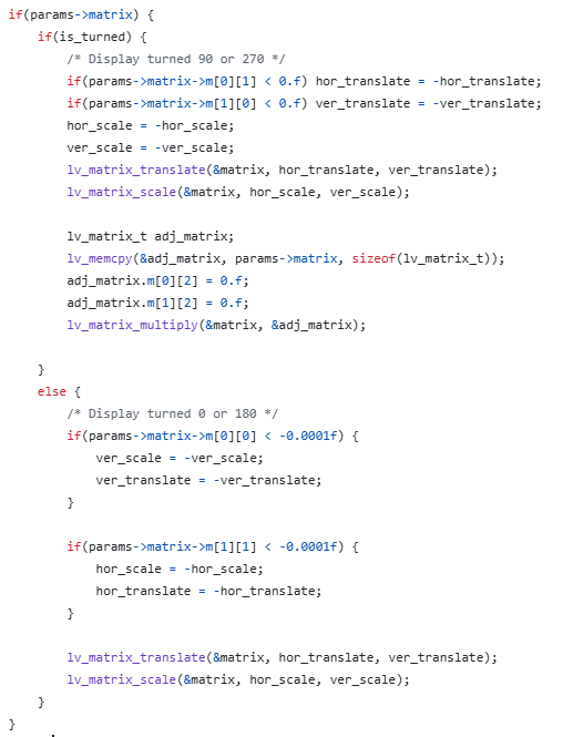

At the same time, in OpenGLES driver, it seems that this driver has already supportted the rotation.
In function lv_opengles_render of lv_opengles_driver.c, there are code about matrix, which can rotate 0 degree, 90 degree, 180degree and 270 degree:
So it seems that it’s not complex to support the rotation in Draw_OpenGLES. I wonder, it there any plan about supporting this? Thank you!
