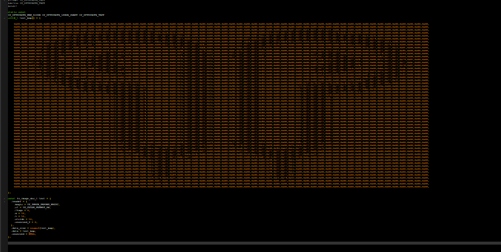

I have the following png file
earbuds
If I convert that into any color model with the v9 converter, I just the zeros in the C array.
Someone an idea, why that would be the case?
Which converter where you using? The online or the Python one?
With the Python one, it works ok as long i select a color format that supports transparency:
With “A8”
On the online converter, if choosing “ARGB8888” or “RGB565A8” seems ok also.
If i choose “RGB565” for example that does not support transparency, yes everything will be “0” since i think is translating a “transparent” icon to black and the drawing in the image is also “black”
Thanks, yes, I figured, that the RGB565A8 indeed does work.
