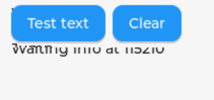

Hello, I have some tabs, if I update the string of the label, I do see some pixels being rewritten but doesn’t erase the previous occupied pixels,I tried this on a label I had but looks like is not refreshing correctly:
strcpy(serial_log_text, "Jump");
        lv_label_set_text_static(serial_log, NULL);
        lv_event_send(serial_log, LV_EVENT_REFRESH, NULL);
If I click on another tab and go back to the one where the label is, it does show everything now correctly.
