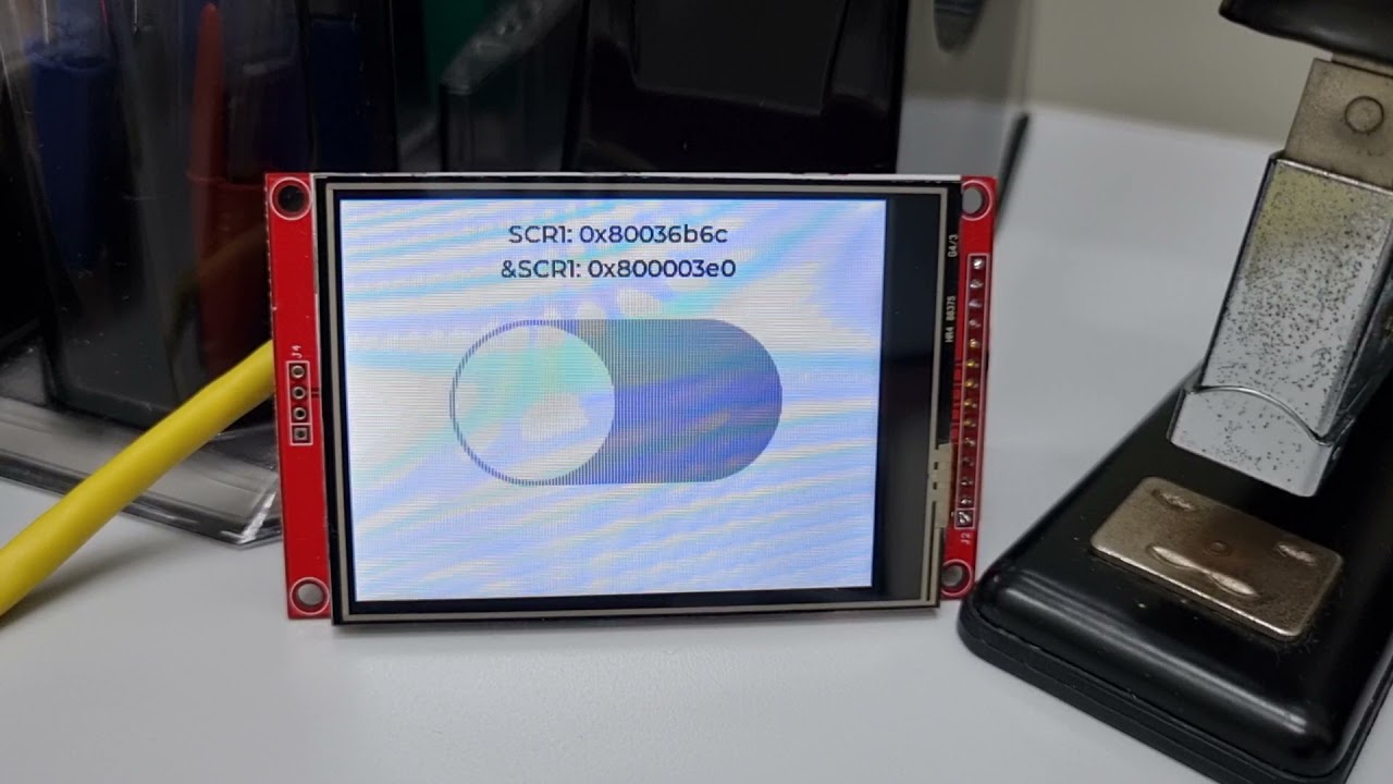

Thank’s @embeddedt, but it still didn’t work. The switch widget “sw” is not changing state when the screen is in steady state, only when the screen is loaded changes the switch state.
Button widget btn1 is working ok.
I’m using lvgl version 8.0.0.

sw = lv_switch_create(scr1);
lv_obj_set_size(sw, 200, 100);
lv_obj_align(sw, LV_ALIGN_CENTER, 0, 0);
lv_scr_load(scr1);
if( prev_scr != NULL )
lv_obj_del(prev_scr); /* prev is now not the active screen, so it can safely be deleted */
a = !a;
if( a )
lv_obj_add_state(sw, LV_STATE_CHECKED);
else
lv_obj_clear_state(sw, LV_STATE_CHECKED);
xSemaphoreGive( lvgl_mutex );
